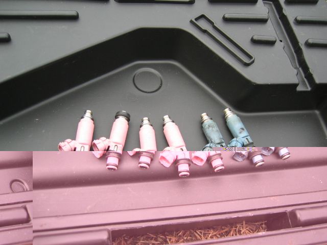

Can anyone give a better description of how to lube the o-rings.
Also, can someone give me a better idea of how to remove and re-install the injectors?
Do you just remove bolts for the fuel line, then remove the electrical connectors, and then pull the injectors up? After removing the stockers, do I then just drop the new one in?
Is the injectors only held to the block by the fuel line?
What's up with this injector with the black thingy on the tip that the other injectors don't have on?
injectors are held on by the fuel rail, just unbolt them and pull up on the fuel rail injectors will probably come up with the fuel rail.
installing them, just do the same in reverse. put some vaseline on the o-rings and push them up into the fuel rail then move the fuel rail into position
