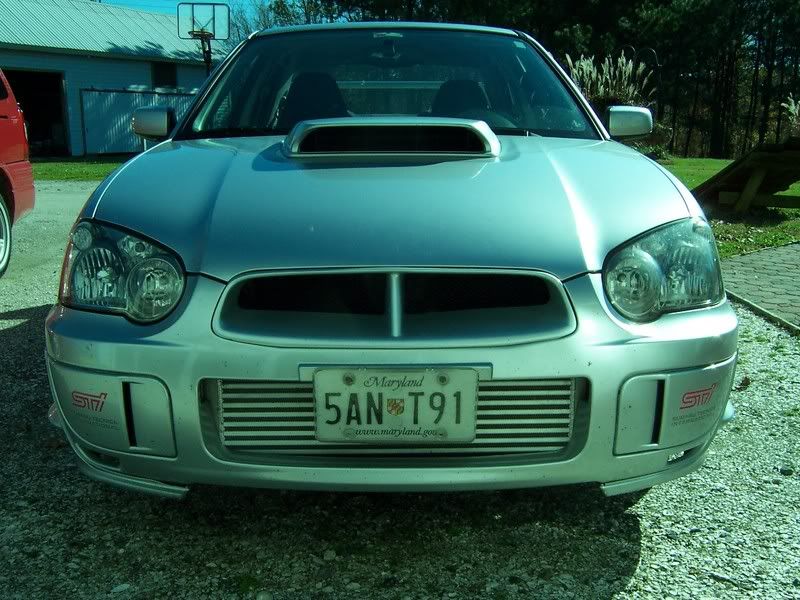

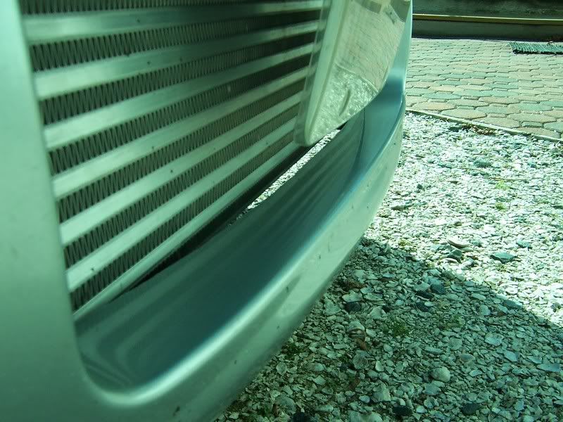

This is a shot from the front of the car. Notice the bumper trim job. About, a quarter the way through my dremmel died. I only had one battery and I was not interested in waiting. Surprisingly, my friend Cody and I decided to use another tool. The box cutter we used to cut the final trimming of the bumper was one of the best decisions of the install. All that we did was tape off 2 inches from the edge of the bumper (make sure the tape is straight) and go at it with a box cutter with a new blade. At first, we scored the bumper on the surface to have a good guide to cut all the way through. And dag on - it worked real well.

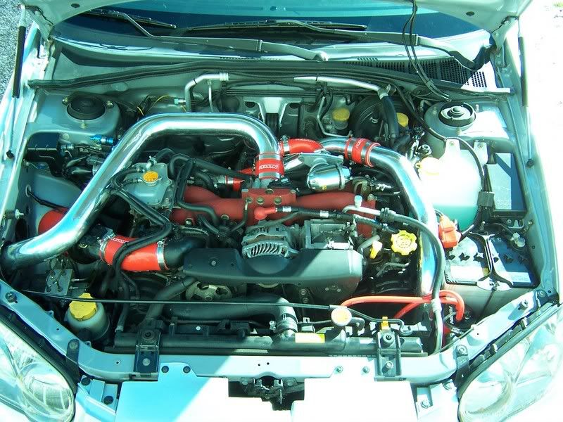

An engine bay shot. Notice all the red -!!! One hangup on the perrin kit is that t-bolt clamps are not included.

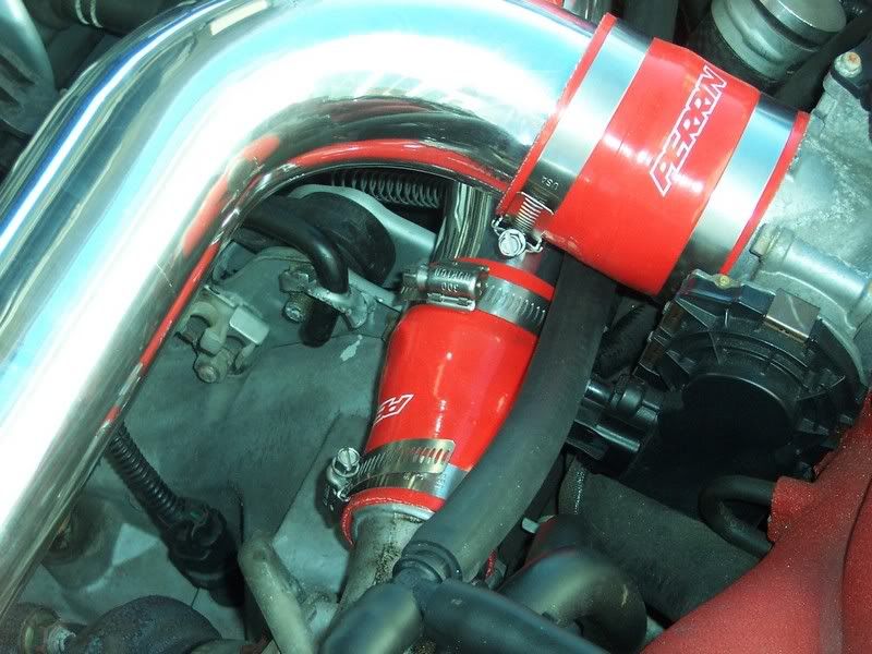

One 'problem' was that on the connection comming off the turbo as seen in the picture - there is a little transmission breather bracket. This bracket was overly close to the silicone and there was not a clean clearance for this tiny bracket and the piping. What did we do? Bend the ***** out of it!!! No, actually kinda. Just bent this little bracket backwards, and I was still able to use the bracket to hold the hose (just in a little different position).

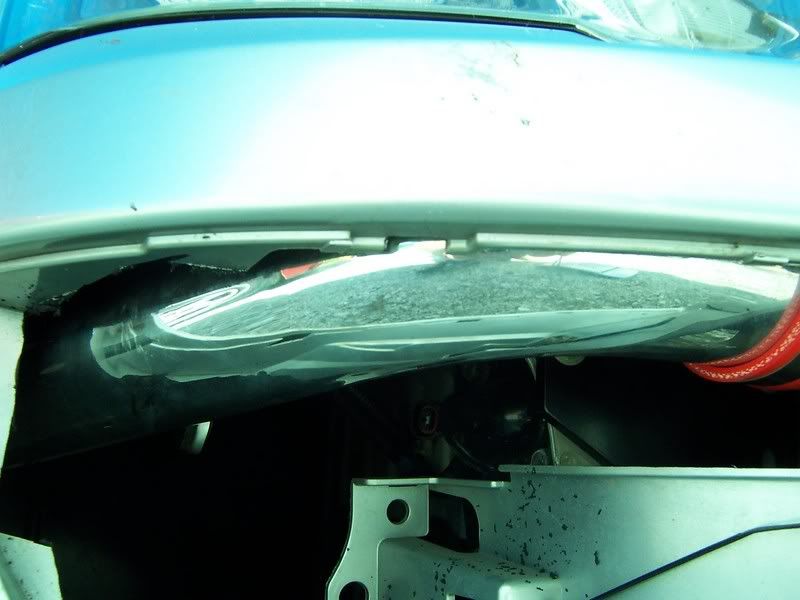

I was aware that the fmic did not retain fog light mounting. I just thought it went into the area where they were installed. Boy was I in for a wake up. You actually have to trim the heck out of the fog light mounting points in the bumper as seen in the picture. Not really a big deal but more of a pain to do more trimming.
