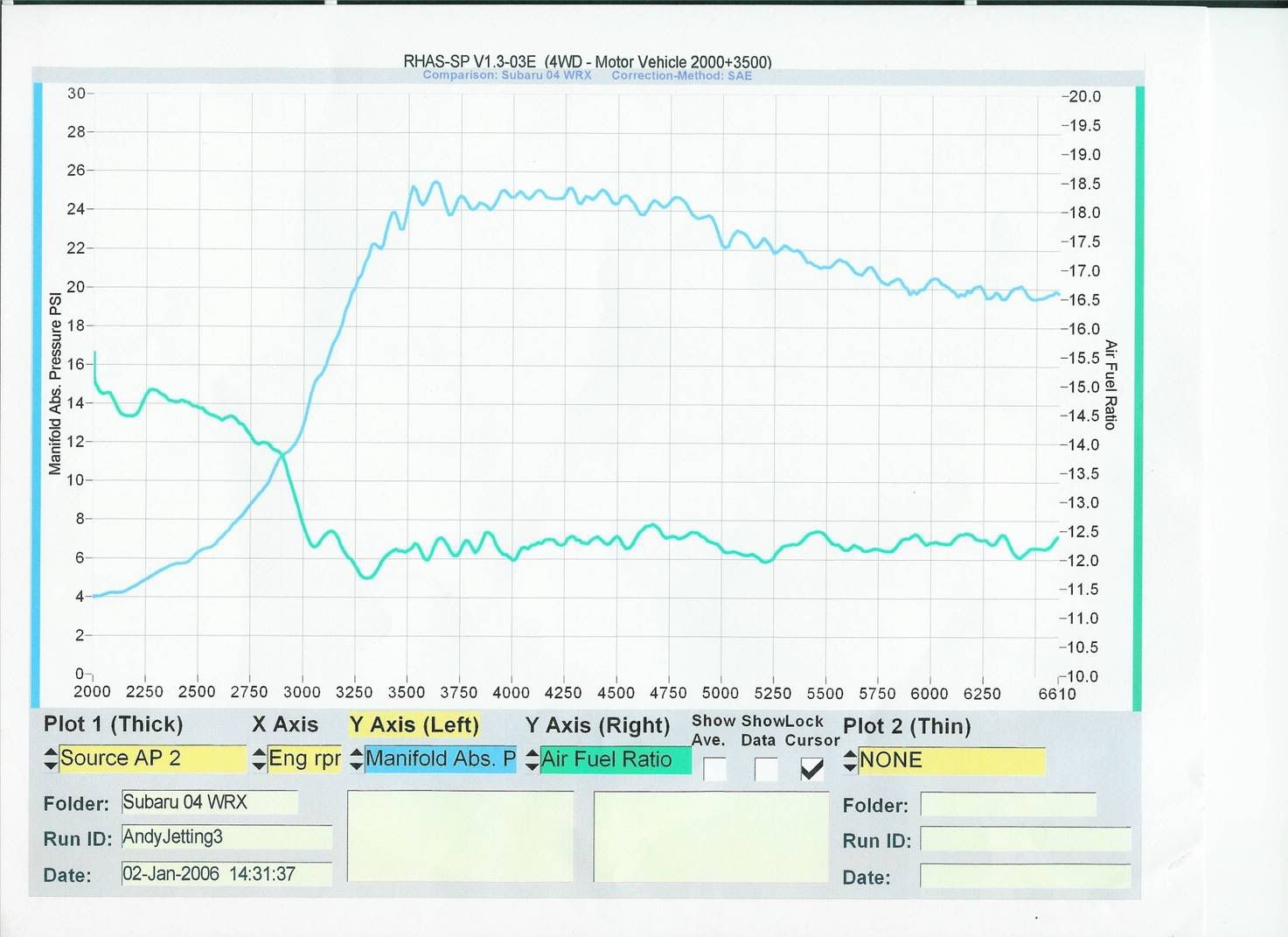

Anyway. The thinner lines are my pump gas map. The thicker/darker lines are the water meth tune. Tuned at 27PSI, but only run about 22-23 on the steet. Your gains should be more profound once you change the turbo, and get another tune. You should gain quite a bit with the stock turbo though.
AFR also:
Maybe it was a little less than 27psi, but you get the idea.
