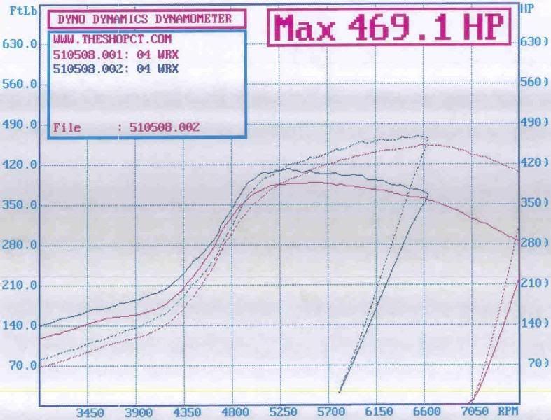

Default FP 3065 Pumpgas 470whp...
FP 3065
Crower Cams
Ported WRX heads
Standard size SS Valves
Springs + Retainers
Turbotrix built 2.5 block
Cosworth Oil Pump
POS FMIC( Probably the worst intercooler I have ever seen in my life )
TXS UTEC + SD
TXS 5Bar
Perrin Rails
RC 800cc
GT Spec Headers
Cooling Mist (NOT USED YET)
I actually street tuned this car.. As you can tell from the run files. It made 450 right off the street on pump gas with 20-21psi.. I turned it up tp 22psi and it made another 20whp until the stock ECU died (ground issues)... Im sure this car will make 475-490whp on plain old 93 octane.. I still have the timing very low.. I knew it felt good on the street, but it was quite the suprise to see the power it made. Next up once I get the ECU sorted I tune it on Meth and then some c-16... I expect the car to make around 520-550whp..
