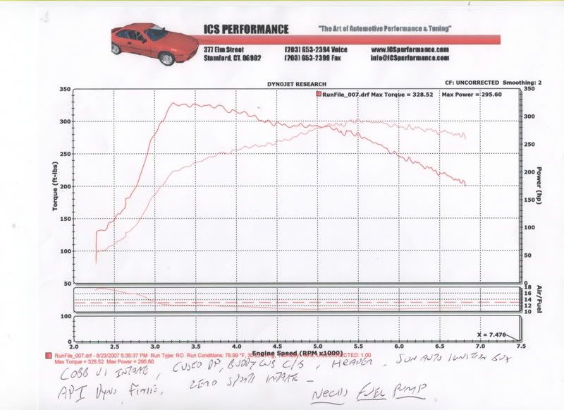

Default 05 STI Stage II 93 Pro Tune Dyno Results
This was a stock fuel pump Stage II car that AL Pro Tuned here at ICS yesterday
The customer did not want to change his fuel pump at this time, although we recomend a Walbro pump on Stage II, therefore, the boost was limited to 17.8 psi max boost
His mods included
Cobb V1 Intake
Cusco DP
Buddy Club C/B 3"
Zero Sport Intake Tube and Header
AP 1 Pro Tune
