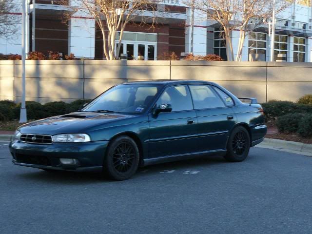

Im sure there were parts im missing here but you get the point.....my biggest lessons learned are:
Send wiring to someone else
make sure you have a COMPLETE donor car
might as well mod it while you build it
when something goes wrong step back and think about it cause you may be over looking something simple
have fun w/ it
Heres a pic
