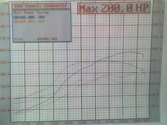

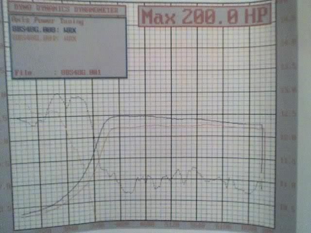

If you ever wondered how rich a stage 4 utec basemap is, take a look at my tune graph. The afr drops richer than 10:1, richer than the dyno would plot. Stupid rich and low boost got me a 200hp baseline, an hour of Ron's time got me about 89 extra. Not to mention my fuel mileage went through the roof! (tank and a half to get there, 3/4 of a tank on the way back)
before and after boost vs. afr
I could feel every bump in the lower graph driving. The new tune drives smooth as can be. Cheapest horsepower I ever bought!
