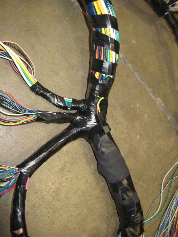

And back to the main stuff. Most of the wiring is now done. Still have to wire in the two stray wires from the fuel pump controller to the ECU but besides that we’re ready to start taping up. We started on all the stuff we new wouldn’t give us an issue. We’re going to leave the ecu untaped until we know the car runs.
