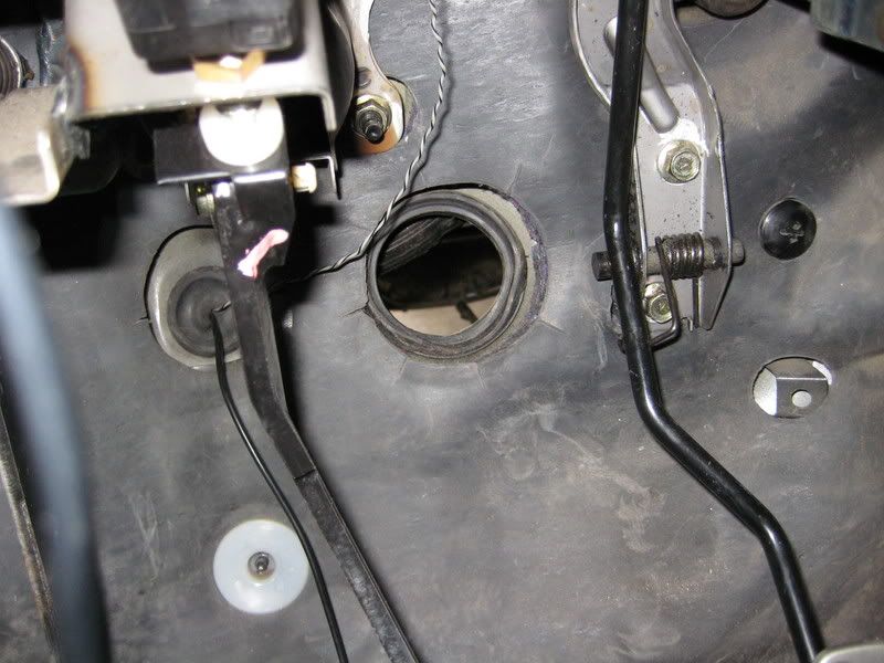

I’m using the WRX clutch cylinder and brake booster/master cylinder. The brake booster is much bigger and covers up some stuff (you don’t really need access to).
Picture of the steering shaft exit point.
Same exit point but from in the car.
