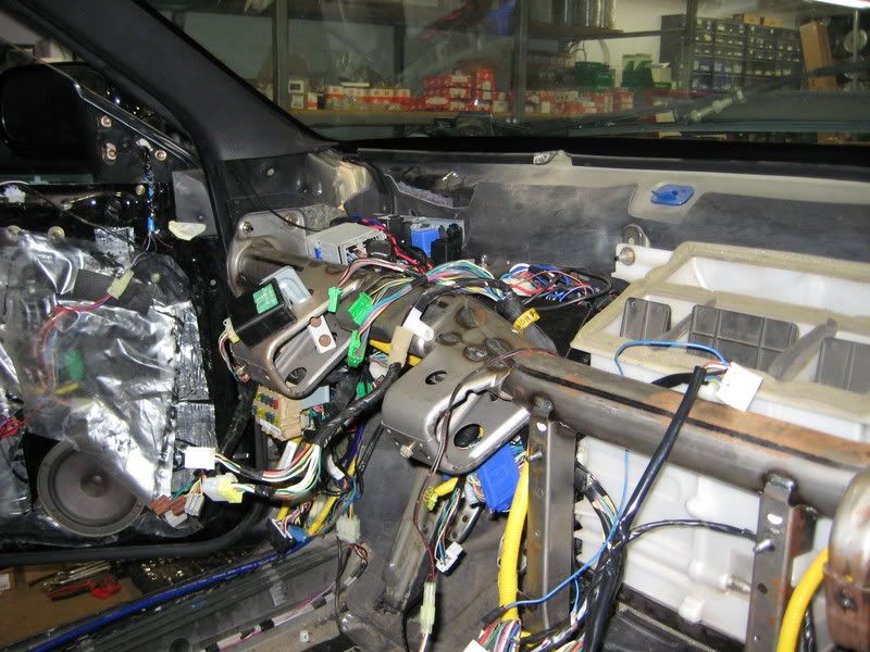

Heated seat relay. There is a factory clip location on the dash bar that fits the relay perfectly. It’s the pink one.
General picture.
