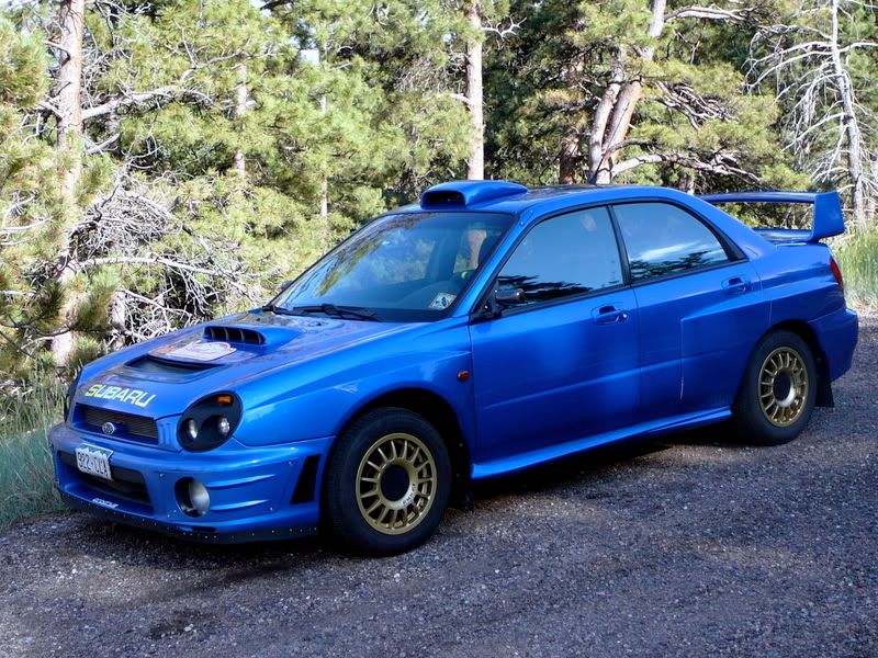

Thus was born the notion that the ideal fast and fun daily driver would be as close as practical to an AWD rally car, and I decided that some day I would build one. After owning a second hand Quattro Turbo and other interesting cars, I bought a WRX in 2001. I gradually modified the car, with the objectives of Group N plus performance and WRC appearance. For fast "stage times" year round on Colorado roads, I settled on a gravel setup with no drop and strong gravel rally wheels. For the mountain roads, I chose GrN close ratio RA gears with 4.44 rear, and modified the engine for quick spool, torque, and day-to-day reliability at 5000-14000’ elevation and –30–105 F temperatures. I drive the car to work daily on a twisty mountain road (2000' vertical) and take it over Loveland Pass (12990') about 40 times a winter. I have over 140,000 miles on the car. Last weekend I drove to the summit of Mt. (7000' vertical), stayed in boost most of the time, and averaged 21 mpg!
Engine: EJ205, VF34, Hyperflow TMIC, MRT UP, MadDad V2 DP with metallic cat, Hayward and Scott Rallye exhaust with removeable silencer, Vishnu pulley, Ecutek tune. GrN engine mounts. And no GrN 32mm restrictor! 354 HP/364 ft-lbs (flywheel)
Transmission: Type RA gear set with 4.44 final drive, custom tall rally short shifter, GrN bushings
Steering: quick steering rack (12.5:1 ratio, 2.2 turns lock-to-lock)
Suspension: STi/SPT springs and inverted struts, Whiteline sways, links, and ALK, Do Luck aluminum front subframe, GrN strut top mounts, side cowl braces, STi aluminum front control arms, Whiteline strut bars F&R
Wheels: OZ Racing Gravel Wheels (GrN) 6.5X15, with Prodrive Impreza WRC lug nut covers; Prodrive P7 7X17; Enkei RC-G4 7X15
Tires: Bridgestone RE960AS 205/60-15; Bridgestone SO-2 215/45-17, Dunlop Winter Sport M3 205/60-15
Brakes: Front STi 4 pots, rear 2 pots. DBA Gold rotors, Carbotech Bobcat pads.
Exterior: Prodrive WRC carbon fiber wing, Burnup/Launsport fenders, STi sills, WRC hood insert, Prodrive WRC headlights, functional roof scoop and inner roof vent, 2003 Monte Carlo rally plate, Hella Rally 1000FF HID driving lights and modified WRC covers
Interior: Sparco Evo II with Scroth harness, custom alcantara dash, suede STi steering wheel, carbon fiber switch panel, e-brake, Ipod interface, ScanGauge.
Curb Weight: 3039 lbs
Sport Weight: 2976 (Co-driver Sparco, back seats removed with carbon fiber bulkhead, JDM bumper beam)
Sound clip (recorded on a gravel mountain road) http://www.4shared.com/dir/8153159/3...9/sharing.html
The car is basically done except maybe some small interior stuff. I just rebuilt the engine at 140,000 miles, and the aim now is to give it careful maintenance, keep it indefinitely, and run the second engine as long as the first. I don't plan a roll cage because its safer without one on a DD and I don't want the extra weight. A full carbon rally car interior would be nice, but I can't justify the expense for a few pounds saved. I have pushed the mods just short of the point where things start getting uncomfortably rough and noisy for a 1-2 hour blast to skiing.
I reckon the acceleration exceeds a group N rally car as it is, and driven 10/10ths on gravel, it is stupid fast.
