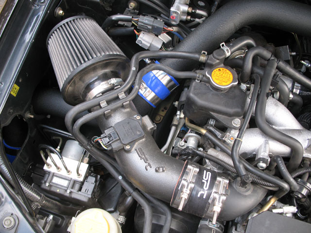

The gmbcs will be fine to be connected into the harness but not used, correct?
You are going to want to cap the nipple on the inlet so it is not sucking in unmetered air on the trip to the tuner:
The one to the right of the 'S' on the SPT coupler
-Rene
