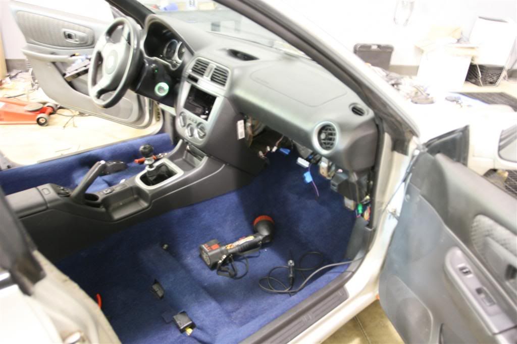

    Interior closer to completion. Note test light, flashlight. Not shown: Curse words.

  • GD dash. We ended up welding in the GD dash support so the dash would fit properly, but we don't think the climate control/heater box would have fit in there. If you left the heater in, you'd have to space out the dash to fit.
  • GD lock cylinders for the body. They're too big, as mentioned above.
  • Wipers and wiper motor.
  • Door cards. The rear doors are obviously a different shape. The front doors actually are the same, but the holes in the metal are in different places. You could bolt in the GD front door cards if you wanted to drill new holes. But then your front and rear door wouldn't match.
  • Accelerator pedal. The STi pedal is drive-by-wire. You'll need to custom-build a bracket for it.

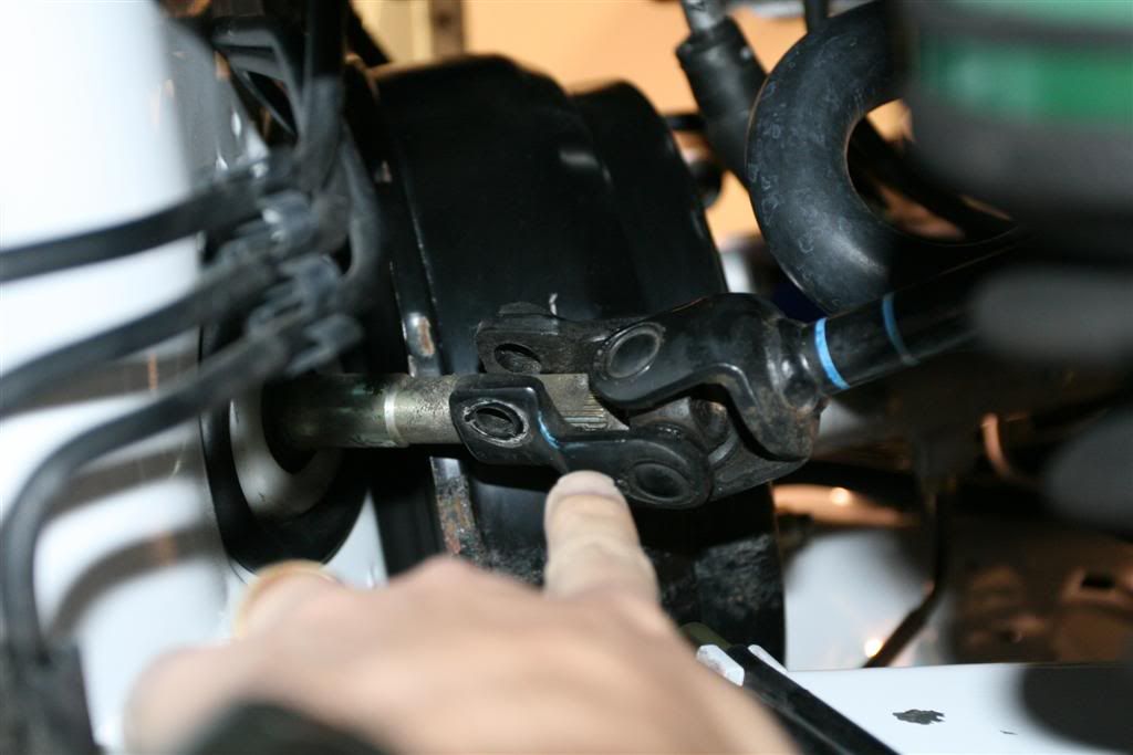

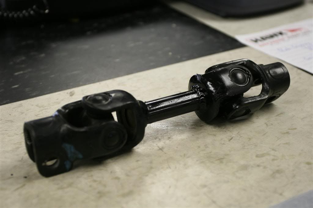

  • GD steering column. It fits, but the GD steering shaft is slightly too long to fit properly in the GC chassis. We cut and welded the shaft, taking out about a 1/2" of length between the U-joints.
    The steering shaft is supposed to end where the two bolt holes are. The blue lines are future cut-and-weld locations.
    Steering shaft segment, post-operation
