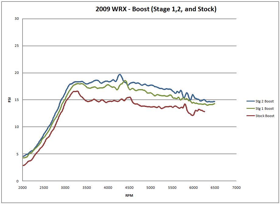

The boost used for the stock, stage 1, and stage 2 runs.

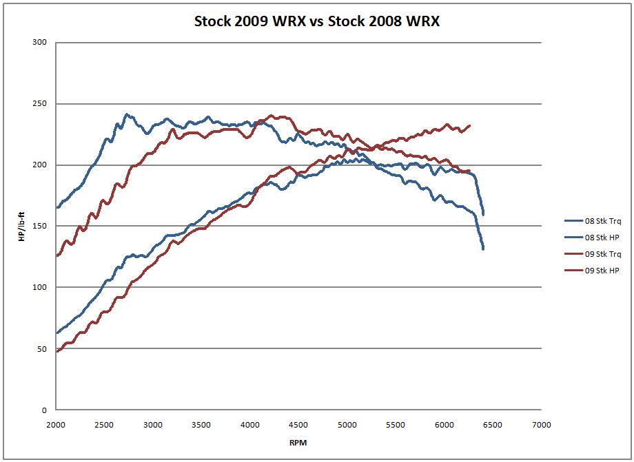

Last but not least, here is a look at the 09 WRX vs the 08 WRX, in stock form. As you can see, the 08 WRX has a torque advantage until about 4000rpm, at which point the 09 WRX takes over and runs all the way to redline. The 09 has more lag then the 08, much like the 08 STI vs the 08 WRX.
