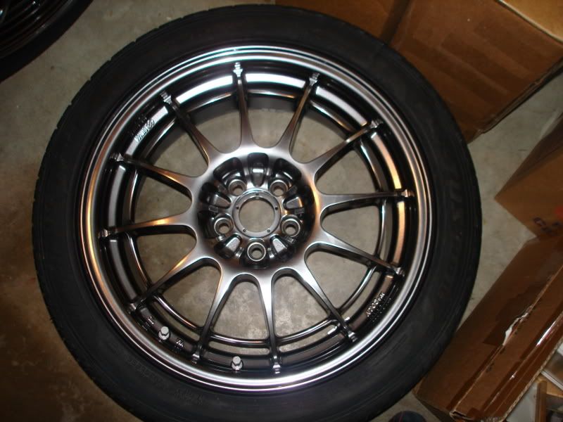

Tiny Brakes hiding behind Enkei NT03-M’s 17x7.5 +35 (thank you Enkei for having ****ty sizes in 5x100 bolt pattern.
