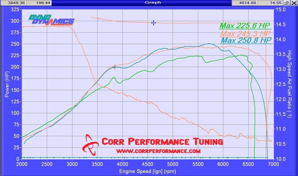

I have had the CAI on since the 3rd day I bought it in dec. No issues. The cobb stage 2 base map supports the aftermarket intakes. But doing and saying are 2 diff things. =) I have included the A/F chart.
I agree custom tuning should help. Im going back out this Sat to tune.
Thanks for the inputs.
