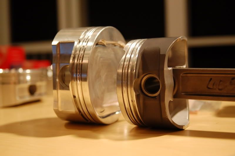

yes, the 4G63 platform does have a taller rod ratio than the EJ25 and shorter than the EJ20 and should only be utilized for an apples to apples comparison without running actual numbers and forces from the difference in rod and piston weights
Its two greatest differences however are the smaller and lighter piston and the much wider oil wedge for the bearings. These help to reduce the force seen by the bearing.
Note 4" Subaru piston vs. 86mm Evo piston
