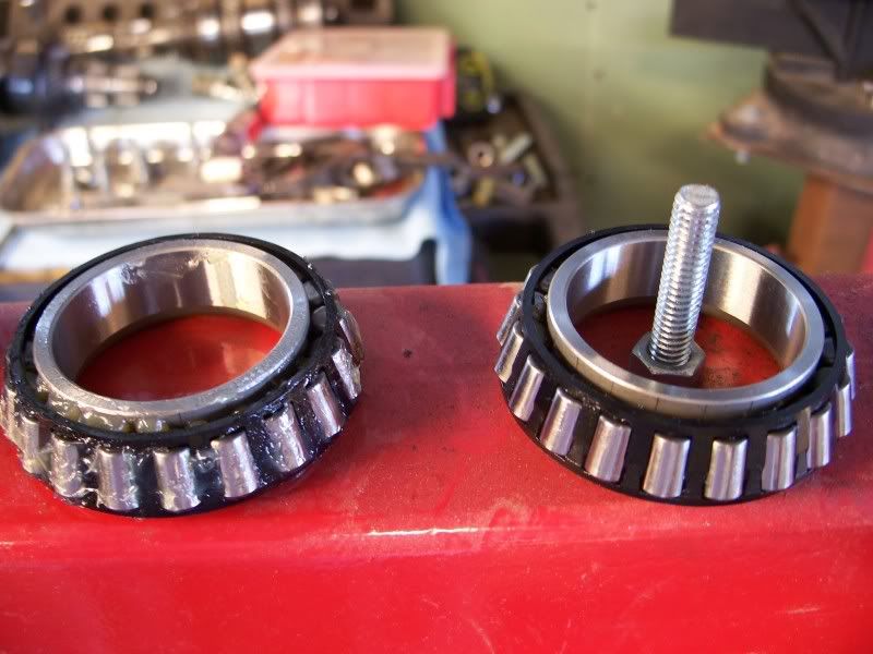

After I had cleaned the packaging grease off
I proceeded to pack the bearings with new grease. I find it easier to just put a blob in my left hand and roll, pack, squeeze the grease into the bearing with my right. It's fairly quick and effective.

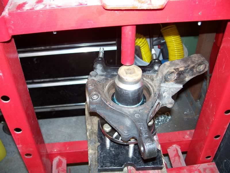

Ahh more stock studs I don't need I guess I'll use the press since the hub is dismounted.
10 minutes later.
Now that I have everything together I can assemble. Put the bearing in the outside and install the oil shield. Then press the hub into the bearing.
After that flip it over and push the bearing onto the hub.
