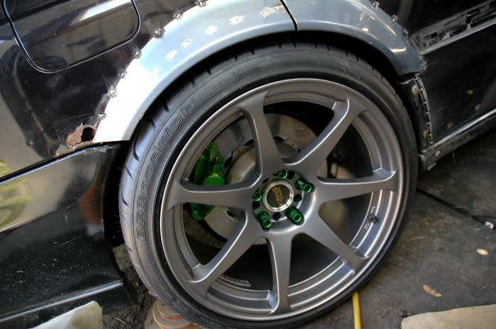

So here are some pics of my progress. Took some 1990 Honda Accord Fenders and cut the flares off to make myself a "poor mans" widebody so I can could fit some new wheels. MB Battle 18x9.5 +15 on BF Goodrich G-Force KDW 245/35/18s. These wheels were only made for 5x114.3 so I swapped to STi hubs that I re-drilled to 5x114.3 so then next step would be to install STi Brembos. Did that and painted them Henessey Viper "snake bite" green and I took it one step further and threw in my Ver 7 RA Spec-C Close ratio 6-speed in as well. Currently the car is going threw the last few tweeks before I give it to my buddy to paint while I jump back onto the Super Scoob.

New wheels:
