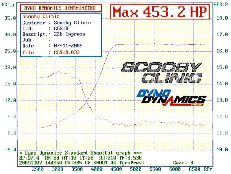

Default 22B + SC 2.3L + Blouch Dom4 XT-R = 576bhp
Event: dyno pull
Location: Scoobyclinic, Chesterfield, U.K.
Ambient Temp: 50
Elevation: 670 ft
Car: 22b
Tuner: Pat, Scoobyclinic
Dyno Info: Dyno Dynamics
Peak HP at RPM: [email protected]
Peak Torque at RPM: [email protected]
Baseline hp/tq for a stock on same dyno: 2.5 STI 275-280bhp
Target Boost: 27psi
Target AFR: 11.6
Fuel: Pump + meth
Engine/Power Modifications:
Scoobyclinic 2.3L engine, 22b/STI 4 Heads with DH22 cams, Solaris
ecu, new Blouch Dom4 XT-R billet turbo, Hyperflow FMIC, CAI
Driveline Modifications: PPG 5 speed syncro box, stock dccd centre
diff, ACT clutch.
Pump gas power & torque
boost & AFR
