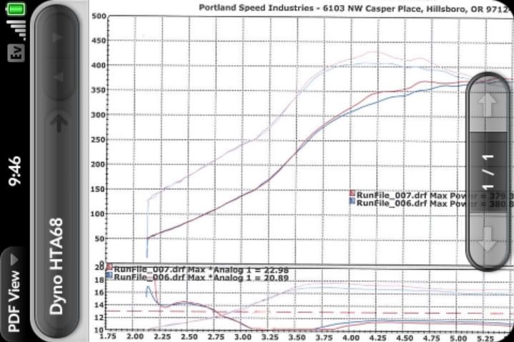

Originally Posted by Concillian View Post
(As if it was ever really a question, the HTA68 is more like a 16g-XT and probably should be compared to a 16g-XT, not an 18g-XT.)
exactly. the only thing thats throwing off everyones expectations is FP's claim of 47 lb/min.
but like i said before.........if they wanna play like that, you should really compare the 47 lb HTA68 to the 47lb 20gxtr.
Anywhoo.....heres a HTA68 on e85....on a DJ....380whp......vf turbos do that
Originally Posted by DG39 View Post
Facility: http://www.tunedbypsi.com/
Type of Dyno: Dyno Jet
Baseline # for a stocker at the dyno: ?
Boost: 23
Fuel:E85
Target AFR:12.5
SAE Corrections: ?
Peak HP at RPM:379.38
Peak Torque at RPM: 431.00
Mods:HTA68, Turbo XS FMIC, AVO SRI, DW1000cc injectors, Walbro 255 fuel pump, Agency Power DP, AVO CBE.
