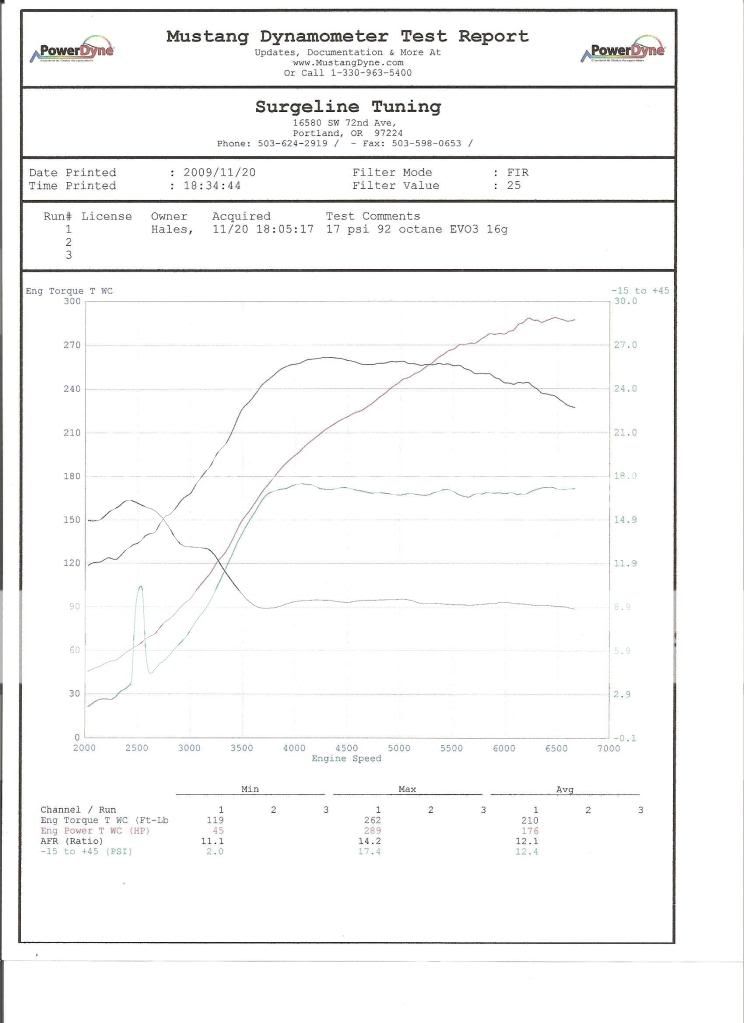

Here are my results:
Blouch EvoIII 16g
DW 850 cc injectors
Invidia catted downpipe
Maddad 3" midpipe
Scoobysport axleback
Grimmspeed crossover pipe
Perrin uppipe
Cobb SF intake and airbox
Gimmick post MAF hose
Perrin turbo inlet hose
STI topmount intercooler
Walbro 255
Grimmspeed EBCS
Group N engine mounts
AP v2 tuned by Surgeline,
17.5 psi, 289 whp, 262 wtq, mustang dyno
E85 soon!
