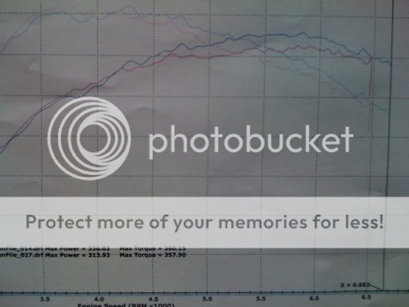

well went back to the dyno today to tune for EWG Tial 38mm. things just seamed to work out a little better with the smoothness of everything so we added 1.5psi of boost and upped the fuel to 94% IDC. all in all the car is really night and day. feels so smooth and powerful. above 4000rpm you can really feel the increase of 10-25HP and TQ all the way to redline!! EWG FTW!!!!!!!
the things in red are all new over the last tune. last tune was 313HP 357TQ, new tune is 330HP 360TQ.
Event: dyno pull and street tune
Location: Applied Tuning, Cbus OH
Ambient Temp: 72 dyno, 55 street NEW 78 dyno, 71 street
Elevation: 902ft
Weather: sunny
Tires: stock Dunlop 225/45/17
Car: 09, wrx
Tuner: Eric Hargett
Dyno Info: Dynojet
Peak HP at RPM: SAE corrected 1.0, 313HP 5900RPM NEW 330HP 580000RPM
Peak TQ at RPM: SAE corrected 1.0, 357TQ 3700RPM NEW 360TQ 4300RPM
Baseline hp/tq for a stock on same dyno: stock 09 wrx 230HP
Target Boost: 19.5 taper to 14.5NEW 21 taper to 15.5
Target AFR: 11.1
Fuel: Shell 93 summer blend
Injectors/duty cycle: Stock 540cc/90% NEW 94%
Timing: 21 degress
Engine Modifications:
Pro tune
TurboXS CBE
Perrin light weight pulley
Invidia catless DP
TurboXS CAI
Gimmspeed 3-port EBCS
Walbro 255lph pump
NGK 1 step colder plugs
TurboXS FMIC
TurboXS RFL BOV
custom blow through
NEW custom oil catch can venting both crank and valves to atmos
Grimmspeed EWG/Tial 38mm
