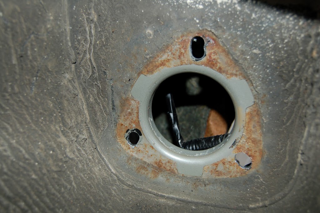

If you swap in 02-07 rear tophats into an older car the holes should really be slotted instead of a new hole added. Without the use of a spacer back there and with only one new hole drilled the tophat will not fit.
Something like this.
I'm not sure I feel comfortable recommending people to modify ALL three bolt holes on each side... That makes it 3x more likely for a novice to permanently ruin their chassis.
Drilling one hole was somewhat difficult enough, but I understand why the slotting make sense, since it keeps the tophat centered and supported by the "hub-centric" type hole.
