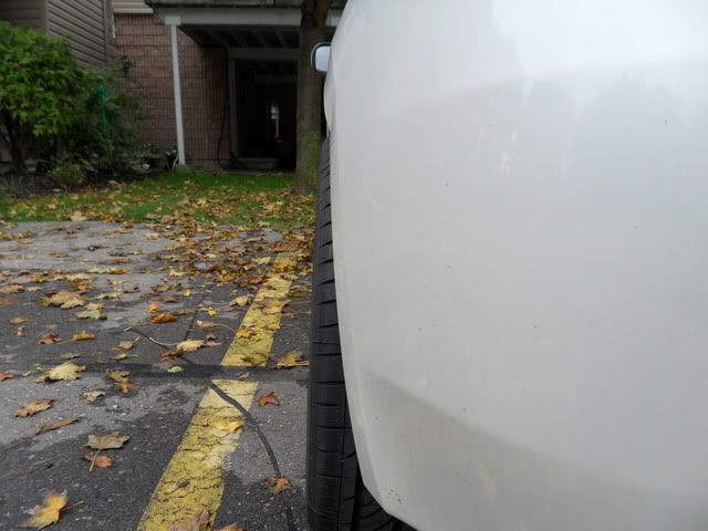

Here's some pictures for fitment reference.
2011 WRX Hatch
Wheels:
Varrstoen 2.2.1's 18x9.5 +34 5x100 Flat Black
Tires:
Hankook Evo V12's 265/35/18
Stock Suspension, Rear fenders are rolled. There's no rubbing. Not sure the roll was necessary but planning ahead for lowering in the spring.
Little Poke
