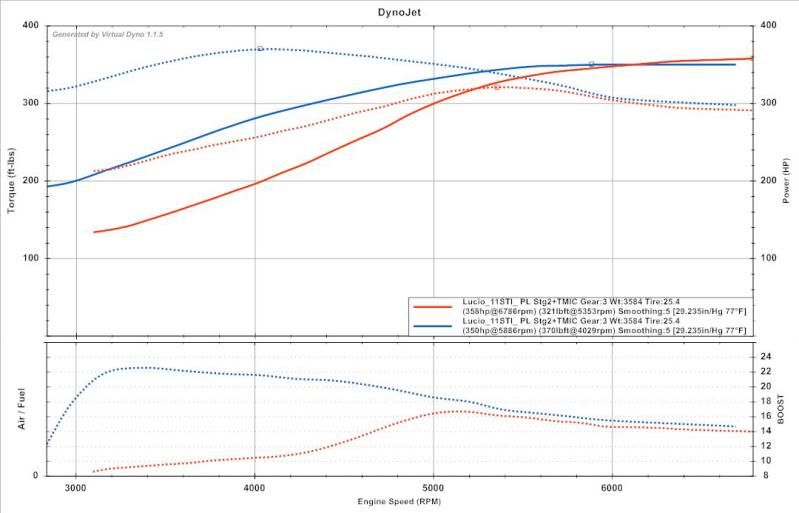

Originally Posted by xluben View Post
VF52?
What's it look like plotted vs. time?
What does the boost curve look like?
Very interesting. Thanks for posting the results!
I wouldnt take the actual numbers to serious. They were data logs from the dyno just to get an idea.
