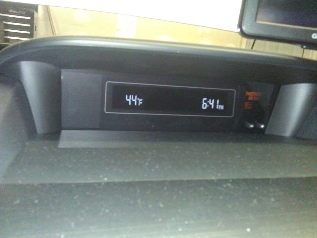

So, I started out last night with an experiment. I unplugged the wiring harness at the abs module. The dash lit up like a Christmas tree, the driver's information center at the top middle of the dash only displayed the time and temp, no fuel info, but it seemed to have the effect on the VSC we are so desperately searching for. So I'm buzzin' around the yard and I crank in into some snow, and go nowhere. No traction conrtol, no VSC, and no ABS, but also no power to the rear wheels. It defaulted to Front-Wheel-Drive! Now I'm stuck. Luckily I was able to plug the harness back in, and on restart the ABS and Traction Control and AWD work, but the VSC and a bunch of other idiot lights are still flashing. Needless to say I felt pretty lucky when I felt those rear wheels kick in, I was getting pretty nervous because I didn't know if the AWD would figure it self out, or if I was going to miss work today for a trip to the dealer. After a couple restarts and about a mile of driving all the idiot lights went off and the car began functioning normally So, Test #1 = FAILED. Test #2 went the exact same way. I unplugged the driver's side front wheel speed sensor. Same results as test one, except I knew enough not to get stuck this time! Car defaulted to no VSC, Traction Control, ABS, and no AWD.

Here are the only pics I could get before my phone died.
The ABS Module Wire Harness:
Push down here and lift lever,
Push up until it clicks in, then pull gently until it slides off.
Idiot lights that were on when the ABS harness was unplugged: AT Oil Temp was flashing, didn't get it in the picture.
The Display not displaying:
