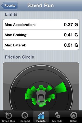

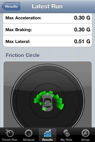

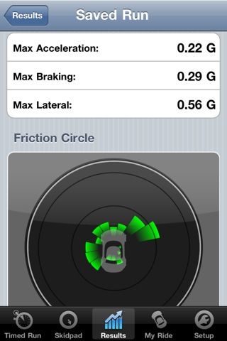

I have finally finished installing my koni inserts with STi springs. Now I need to dial them in a little. I am using the skidpad part of the Dynolicous app to help me see what is going on. I can feel the improvements but this is a little better.
Stock
Another one with stock worn struts where I really almost broke loose.
Rear koni's and STi springs installed.
All 4 Koni inserts and STi springs.
