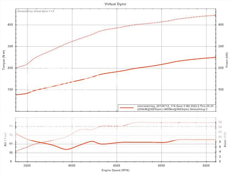

Quick update. I've done a little tuning and I've almost maxed the 65mm CAI and getting close-ish to the 300g/s hardlimit. This is only with 1.1 bar, slow ass spool, 5700 RPM and about 15* timing. Here's a Virtual Dyno, but I think it's a little enthusiastic. There's a drag day on the 21st which I hope to get to, but unsure how well the weather will hold..
