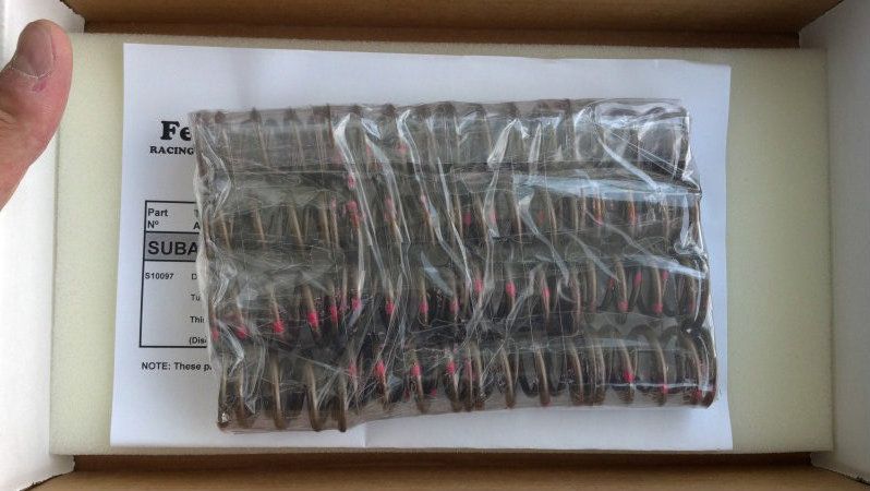

It sucks having to do the heads for a second time but it has given me a chance to rebuild even better this time! I ordered everything a would need from Ferrea(competition plus valves, valve guides, stem seals, lockers, retainers and "dual spring" valve springs) and Cosworth blueprinted oil pump instead of the Supertech valvetrain and OEM oil pump!
One thing I will note is the difference in packaging between Supertech and Ferrea! It may not mean much to some people but simple things such as packaging can show a companies dedication to quality...
For comparison, my Supertech valves were wrapped in a plastic and a rubberband! Now check this stuff out!
