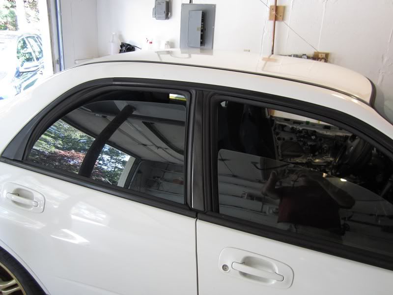

When I pulled the glass out I butchered the tint pretty badly. Seems inevitable. I wanted to get the tint removed prior to the the new window motor arriving. Pretty simple job really:
1. hold an iron about a half inch above the tint and hit it repeatedly with steam button.
2. Get a corner started with a razor blade, something to hold onto.
3. pull. heat. pull. heat. pull. heat. 5 minutes later you are done.
I'm probably going to retint the window once it is reinstalled. The car looks pretty good tinted.
Agree or should I remove it all?
Opinions???
