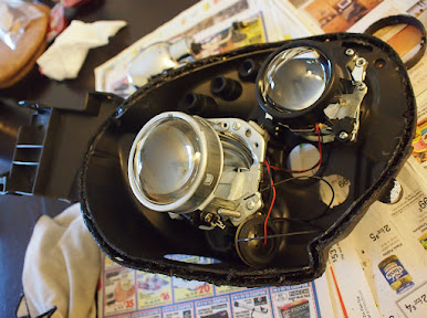

Nice DIY. It looks like the part used is the one that is mostly horizontal, and a small part that transitions to vertical.
Originally Posted by CrashAstern View Post
Ditto for this request!
I've got an '03 bug eye, I wonder if there's a similar look for my car as well.
There is. Light output is a downgrade from the oem reflectors out the box. Good platform for DIY though.
Don't bother buying the one bundled with a plug-n-play HID kit; it just makes the output look brighter but at the wrong places.
Easiest retrofit would be a Morimoto Mini H1. But it can take bigger (and better ones):
