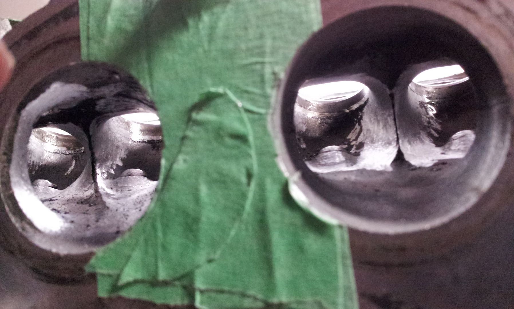

Here is the JDM-like work done to a WRX 2L head. DD shape applied.
Here is the exhaust. Clean up around the valve guides, smoothed out short turn and splitter work. Valve job soon to come.
