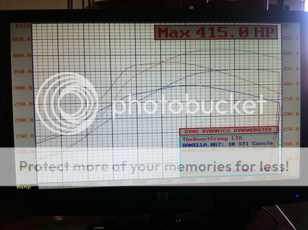

Hello everyone I finally have some data for you from my build.
The specs:
2010 STI
Cosworth 2.5L 8.2:1 SB
+ 1mm Valves
Tomei DAVCS 252 Cams
Blouch 2.5 XTR TS
ID 1000
KS Tech Intake
E85
15% Correction factor for 5000'
Best of the Day! 21PSI
Where she is happiest... Backed off 2 Degs... held 20PSI till redline.. Full Load to take me into the mountains
Best we did last time... Changed out the intake... She was choking...
Not sure why this is a video, but this is our 91 Tune.... great road trip map... also to the mountains
