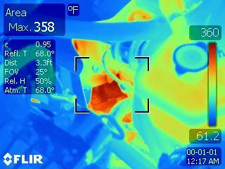

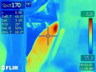

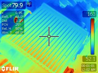

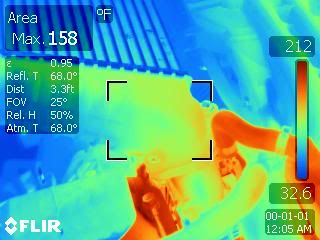

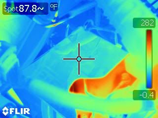

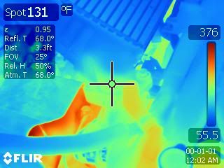

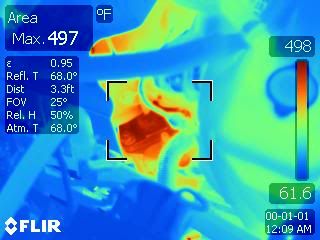

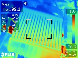

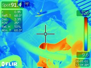

these first infrared shots are the before heat wrap. one shot is the engine at idle for 15 min after operating temperature is reached, and one is the componants after driving with a couple of full throttle pulls before opening the hood. these shots will give us our baseline for the duration of the entire study of all three products. keep in mind these shots include the PTP turbo blanket installed.
GRIMMSPEED heatshield idle
GRIMMSPEED heatshield after driving
turbo area idle
turbo area after driving
downpipe idle **informational only, disregard for testing**
downpipe after driving **informational only, disregard for testing**
TMIC left side at idle
TMIC left side after driving
TMIC middle at idle
TMIC middle after driving
