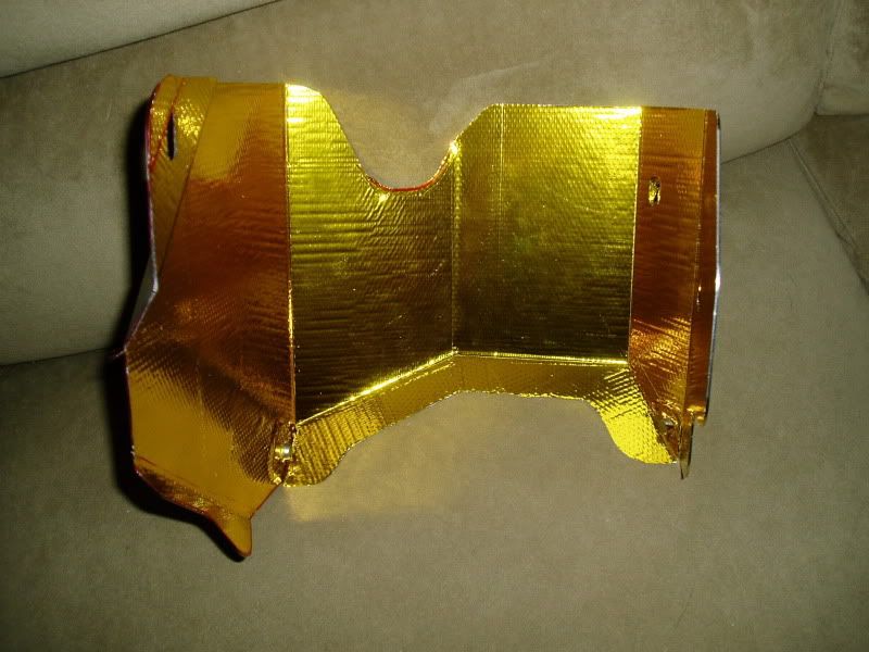

Here are some foil and shield results
Product #2 is DEI's reflect-a-gold foil tape part # 010392 12"x24" sheet
product features
-made of space age polymer
-withstands continuous temperatures of 850 F
-self adhesive
-minimal clearance needed
-ultra light weight
Product #3 is DEI's floor and tunnel shield 2 part # 050501 3.5 sq ft
product features-
-excellent heat and sound barrier
-wind and water will not effect adhesive
-minimum clearance required, only 3/16" thick
-aggressive self adhesive backing holds past 450 F
-easily shape, trim, peel, and stick. sticks to fiberglass
-constructed from 10 mil aluminum bonded to a finely woven layer of high temperature resistant glass fiber
here is the heatshield underside gold foiled
The TMIC has a combination of the gold foil and the aluminum shield. Only the hot side of the TMIC is gold foiled. The top and bottom of the TMIC got the aluminum shield.
