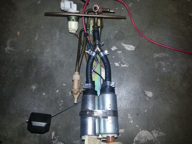

Here's my new setup. I added a Walbro, Soldered the two pigtails together, then soldered 10ga wire to the positive and negative wires on the pigtail. The relay is hooked up the exact same, im just not using the factory plug pigtail that plugs into the pump. This way, it doesnt go from 10ga wire to factory wire, Its all 10ga. Since im running 2 pumps not, I didnt add another relay, I just bought a 60amp relay to replace the 30amp relay.
