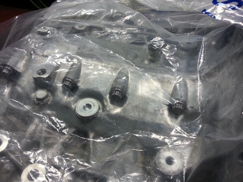

After tearing it apart we found a few problems with the block:
1. The block mains were stretched out .005"
2. The connecting rod bushing were extruding from the rod
3. The wrist pins were slightly bent
The use of the OEM case bolts caused the case to stretch and try to separate but probably the most interesting things were the bushings being pushed out of the rods and the bent wrist pins but I guess the head failure was somewhat of a blessing because we were able to fix the problems before something more serious would happen
Another thing that I became aware of was that I am in-fact using a 704 casing but bcz of time I had the block build, I was almost positive that I was using a 703 casing but thankfully after almost 8k miles on this block, the stock sleeves look brand new with no signs of abnormal wearing or cracks through the inspection, testing and reassembly process that I will cover next!
After finding this out, we took the following steps:
1. Machined the block halves and line main hone with upgraded ARP case bolts
2. Install new main bearings w/ clearances ranging between .0026 & .0028'
3. Install new rod bearings w/ clearances ranging between .0023 & .0024"
4. Honed connecting rods & installed new "classified" high quality bronze connecting rod bushings
5. Installed new CP piston ring set
6. Installed upgraded CP "Tool Steel" wrist pins(These are not the same type of wrist pins that came with my pistons)
7. Fresh cylinder hone using torque plate and ARP L19 head studs
8. Fully balanced rotating assembly
Now this all of these issues addressed the shortblock is ready to be installed and attached to the heads which I will put an update about shortly!!!
