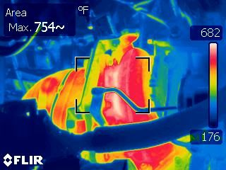

Originally Posted by juanmedina View Post
will it fit a FP black? I am running no head shields or anything right now
you may want to seriously reconsider that. this is a bare turbo after a hard 1,2,3 wot pull, X2, then popping hood and running to take image. after about a minute it will cool back down to a normal driven 500-550F
37F and windy, 2 nights ago.
