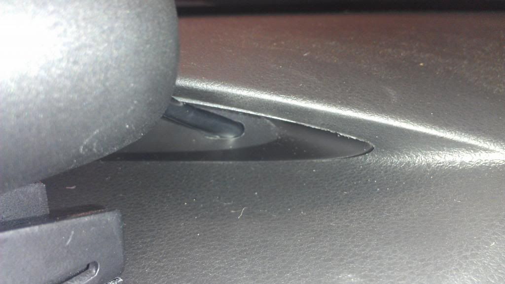

There are lots of places to wire it up. Most people play it safe and use a fuse tap for the power source. I have my gauge spliced into my clock harness and grounded on the radio head unit. You only need two wires, black (ground) and red (12v ignition switched). The other two won't be used.
Here's how it looks:
