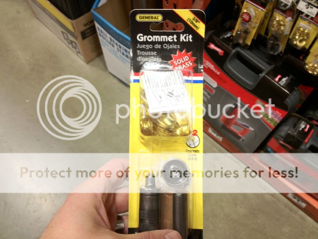

3/8" or 1/2" Metal Grommet kit (read ahead, size depends on setup)

Here's pics of items you'll be looking for at Home Depot:
