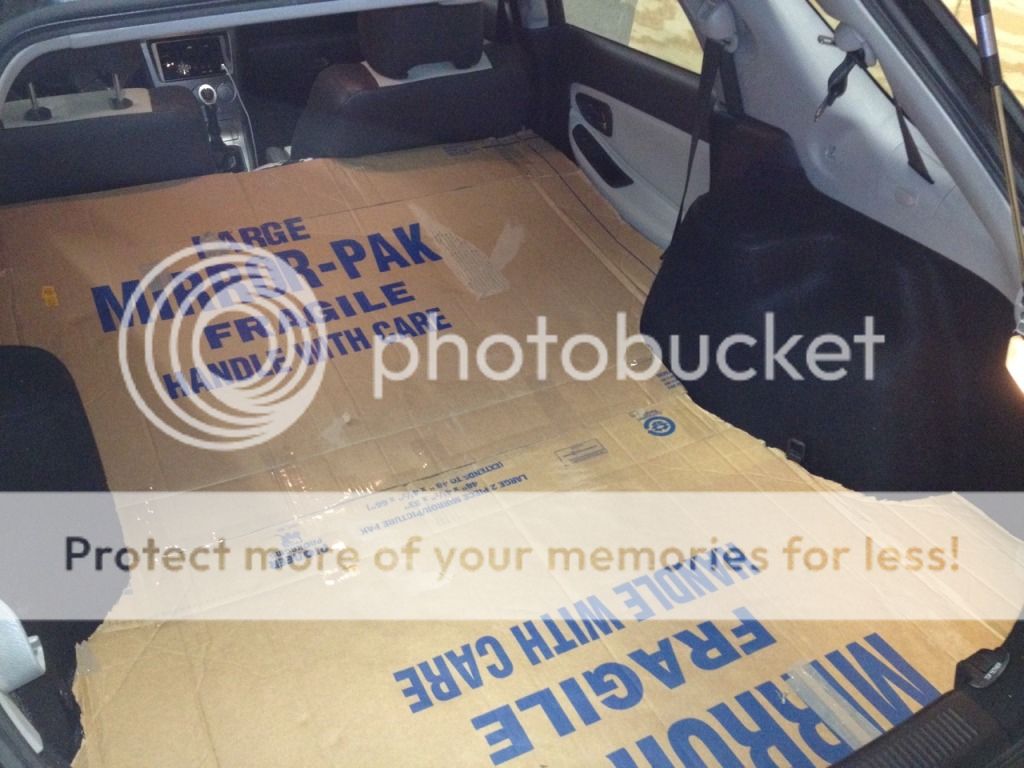

First, remove the lower back seat if you have a WRX or other wagon that the seats do not lay completely flat and lay down large pillows to protect the upper seat and reduce stress on its hinge:
Next you will need to make a template of the entire cargo area from the cardboard. You will need to leave a 1/2" gap for the side panels to fit. The tighter you keep it to the side, the more 'cupping' you will have, which may not be a negative if you're carrying something that can spill. Try to make the lines you cut as straight as possible, even on slightly curved areas, the tabs for the sides will need to fold on a straight line after all:

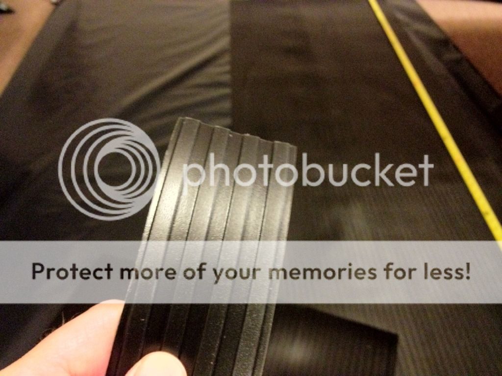

Cut a strip 4 'ribs' wide off of one of the pieces. If you're OCD and need your seam perfectly in the middle, you can cut several pieces of smaller length out of the main roll:
Lay down the strip and run a glue line down each side and join your floor pieces together:
