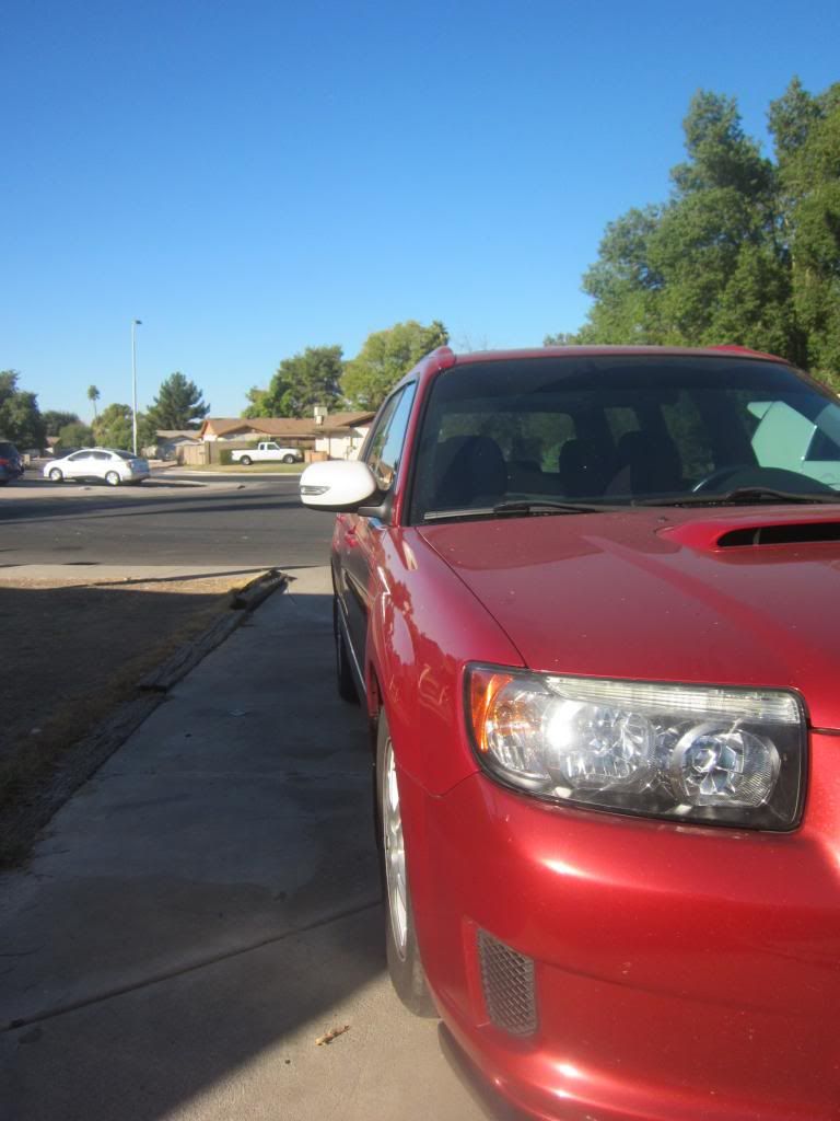

and how they look on the car, i will need to paint the covers next week but you get the idea
