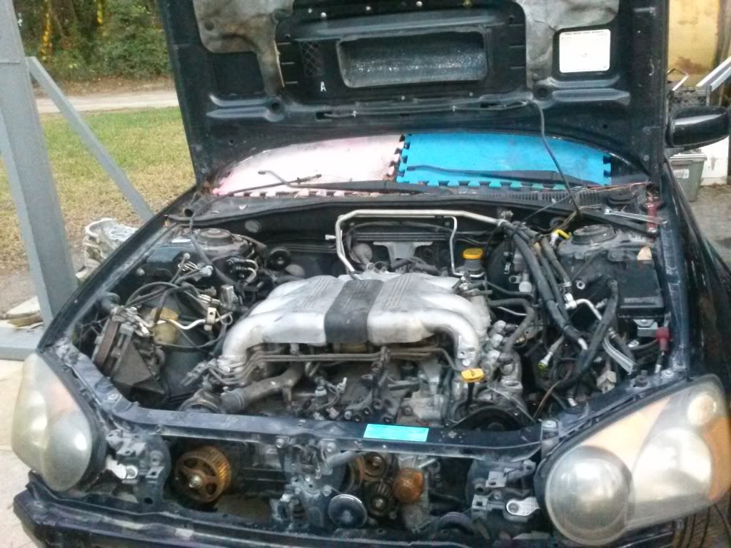

So with the persuasion of a big hammer the big block eg33 is now sitting in his new home.
And with the way it looks, if I remove the hood latch and notch the crash bar I should be able to fit the radiator, condenser, and fans.
Baldturbo do you have any pics of your fab job for the exhaust and the radiator?
Really any pictures of your swap would be of great help.
