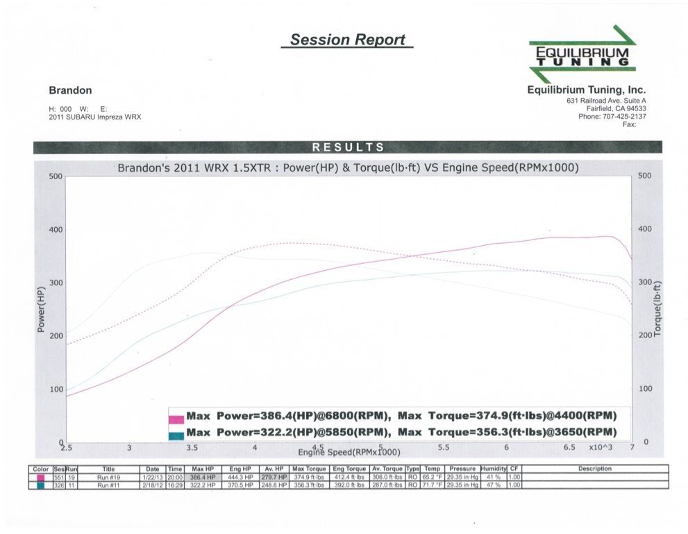

DGM
Car: 2011 WRX
Facility: Equilibrium Tuning
Type of Dyno: Dynocom
Boost: 19psi
Fuel: 91 Octane
Peak HP at RPM: 386.4 @ 6800
Peak Torque at RPM: 374.9 @ 4400
Power Mods:
- EQ Stage 1 Built Motor (Stock compression)
- EQ Stage 1 Heads
- AEM Cold Air intake
- Perrin Turbo Inlet
- EQ 1000cc Injectors
- Walbro 255 Fuel Pump
- Blouch Dominator 1.5xtr Turbo - 8cm hotside
- Processwest TMIC
- EQ Crosspipe
- Harman Motive Catted Downpipe w/ EWG rerouted
- Invidia Q300 Catback
- Tial 38mm EWG
- Turbosmart BPV
The pink line is the 1.5xtr
The aqua green line is on the VF52
