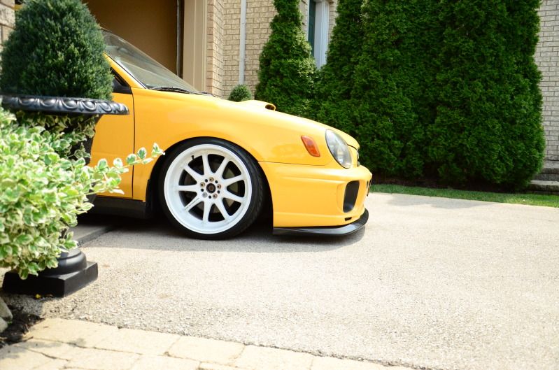

What are the rim and wheels specs? The works look really wide and your still rocking the stock fenders. That is amazing to me.
Its quite the hassle to get them fit, but it works aha.
fenders are rolled front and back, 225/35/18 on 18x10 et 38 front and 33 rear.
