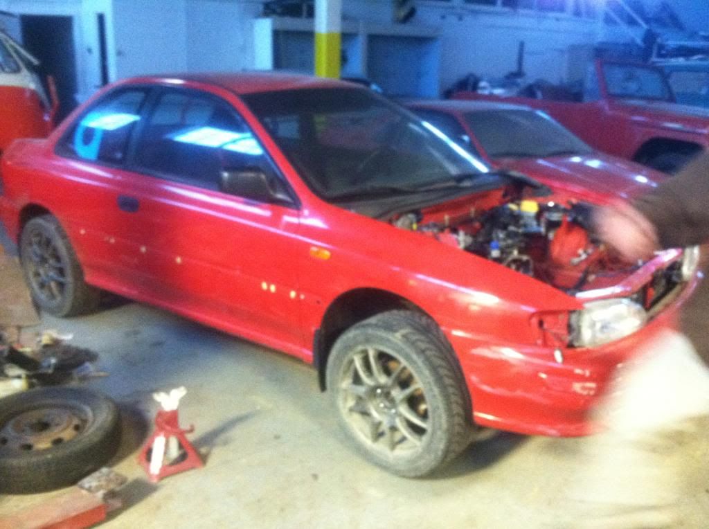

Hi there Nasioc! I am benji! I am 21 and a long time forum lurker but have not made many threads. I created this thread to document my EG33 swap into my Impreza L. I bought my red 1995 impreza L 2 door with a 1.8 L from my buddy Cody for $300. It had spun a bearing and the engine seized. I pulled the engine out, gutted most of the unnecessary parts behind interior pieces, removed the rear seat, A/C, System, and the SRS system and gave it a good scrubbing.

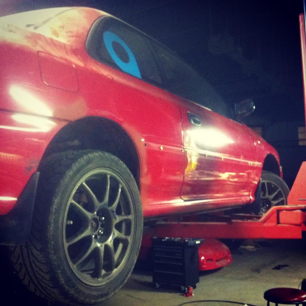

My L on the lift

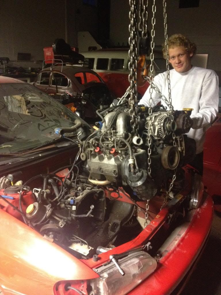

Pulled the engine out
Engine out

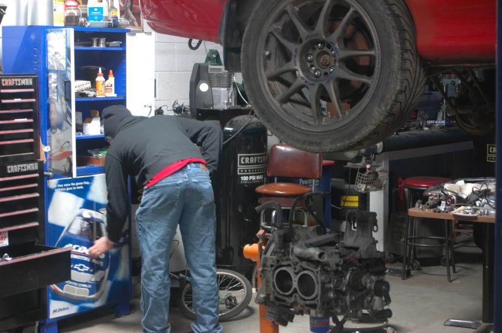

me looking for something with the engine all torn apart under my L

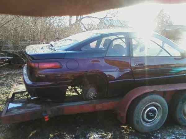

These are the pics the owner put of of the SVX on Craigslist

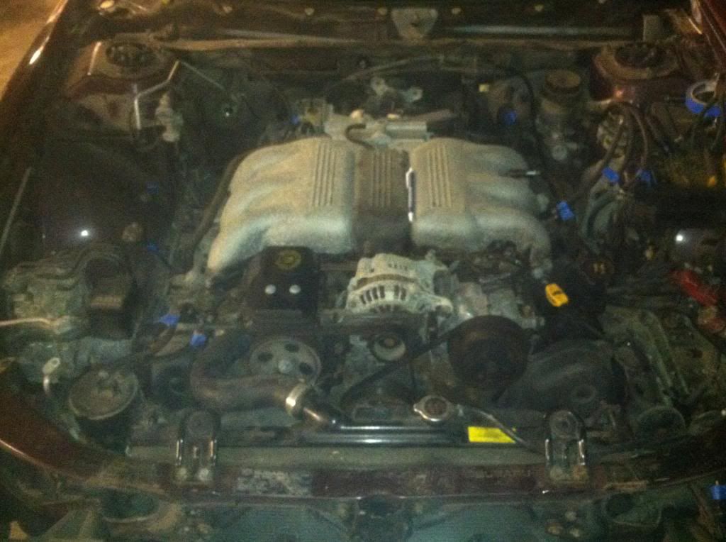

Teh EG33, pretty clean minus the power steering pump was leaking
