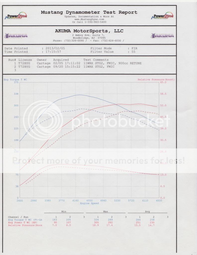

Default 2011 WRX Stage 2 Retune
Event yno Tune (Re-tune with FIC 900cc)
Location: Akuma Motorsports
2 Amboy Ave
Woodbridge, NJ 07095
Dyno: Mustang AWD 500
Tuner: John Shafer
Car: 2011 WRX
Mods: Stage 2 (DP,CB,FMIC,EBCS,FIC 900CC,CAI,DW65C)
Tuned using: Cobb AP
Weather: 40 Degrees, Cloudy
Elevation: Sea Level
Numbers: W/ Stock Injectors-282whp,289wtq
W/900cc's-305whp/334wtq
This Stage 2 WRX was previously tuned with stock injectors as shown on the graph below. During the tune we had run out of fueling to play with so we had jst recently re-tuned the car with a set of 900cc's thanks to Fuel Injector Clinic. This allowed us to add a little more fuel, boost, and timing. Check it out.
