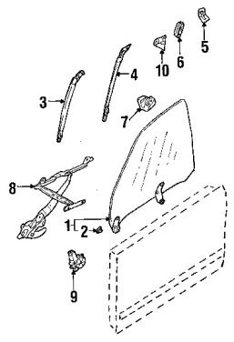

Originally Posted by SilverBOXER4 View Post
You will need to remove the door card to get to the window motor. On the image, #2 is a screw that lock down the window #1 and the bracket #8. Unscrew that 2 screws and you should be able to take the window out.
great thanks! Appreciate the help. I have to put the motor in the door too so hopfully that isnt too hard.
