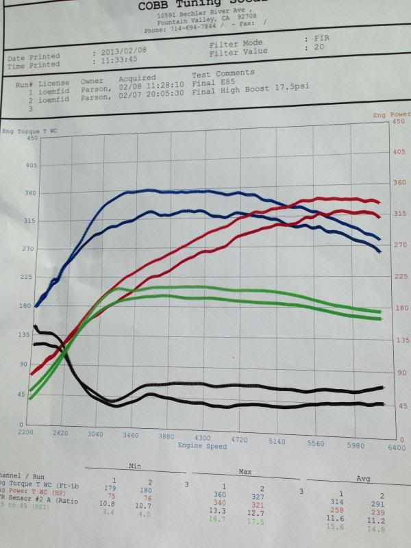

I meant to post this awhile ago when i got it done.
Parts:
AEM Intake
Perrin Turbo Inlet
ID 1000cc Injectors
COBB EBCS
Tsudo Catless DP
DW Drop in Fuel Pump
FMS TMIC
Tuned at Cobb SoCal
91: 321Whp/327tq boost:17.5psi
E85: 340whp/360tq boost:18.7psi
Car drives really nice especially on E85!!
